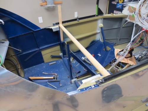

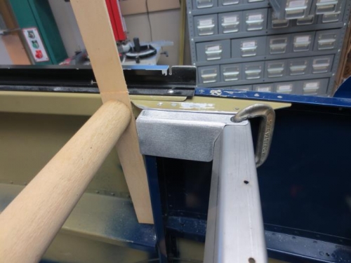

The side supports were riveted in and the new seat support fit up. I made sure to spread the fuselage back to its original measurement of 42 9/32". The Supertracks modification that I previously installed is going to work out just fine with the Almost 14 mod.
Side bracket installed
Installing new seat support
Getting the width back to orignal
