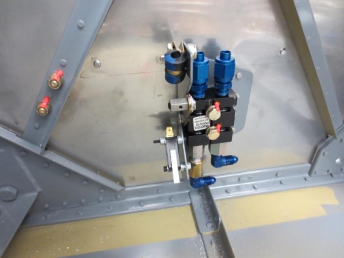

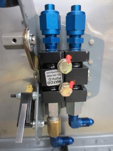

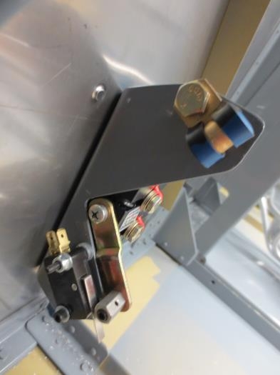

Today I finished the parking brake. With the lever in the up position the valves are closed and the brake is set. With the lever down the valve is open and the brake is off. In this position the microswitch is activated. Once the lever starts to move from the OFF position, the micro switch will release, ground a signal from the Dynon system and flash a visual warning on the EFIS.
Parking brake installed
Parking brake ON
Parking brake ON
Parking brake OFF
Parking brake OFF
