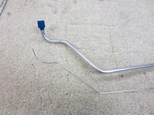

Brief Description:  Fabricated fuel return line
This took me three attempts to get it right. It is securely fastened down with the adel clamps. One trick that I use is to make a pattern with an aluminum TIG wire and then fabricate the tubing. It really helps to make sure that the left, right, up and downs straight. Reduces the scrap pile.
Aluminum TIG wire for patterns
