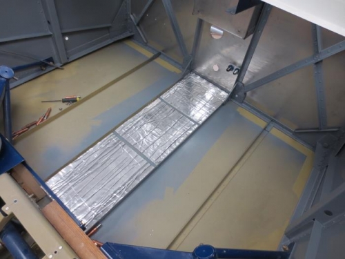

Brief Description:  Installed deadening material below fuel pumps
To deaden the oil canning that is prevelent on the RVs, I installed a self adhesive insulation material below the fuel pumps. The gaps in the insulation is to allow room for the angle iron supports under the feet of the fuel pumps.
