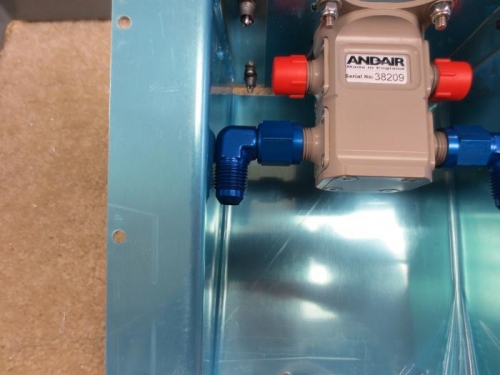

Fitting fuel valve
The Andair valve did not fit well in F-983C due to the Andair straight fittings. I installed the street 90's but there is not enough room for the tubing fitting. It was even worse on the front side. I ordered special fittings from Andair.
Not enough room for tubing fittings
