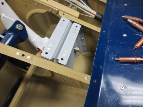

Brief Description:  Installing 5th point seat belt harness
Today I started the installation of the anti-submarine 5th point seat belt hold down brackets. This was fairly straight forward it just is taking time. On the copilot's side I had to add a shim to the top side of the forward bracket. I set it a little low. In the end it is fine. I will finish tomorrow.
One thing to note. Van's instructions call for a -5 bolt. Crow's harness has a 1/4" hole. I had to drill out the Crow harness to 5/16" because I had already drilled the Van's bracket. In hindsite I would have drilled a 1/4" hole in Van's brackets and used a -4 bolt.
Copilot clecoed
Copilot clecoed
Copilot riveted
Copilot riveted
