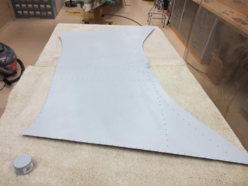

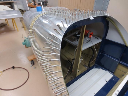

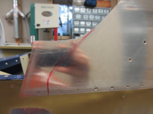

I trimmed the front end of F-674 in preparation to rivet to the fuselage. Drilled the final holes, Shaped the edges, dimpled the holes and primed the underside. Clecoed and ready to rivet it to the fuselage.
Trimming the leading edge
Primed the underside
Ready for riveting
