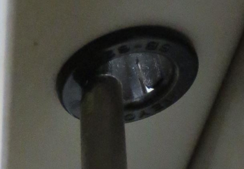

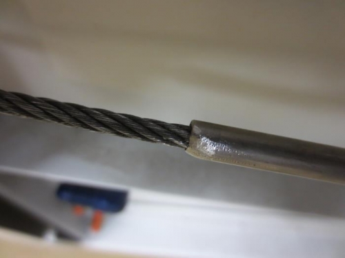

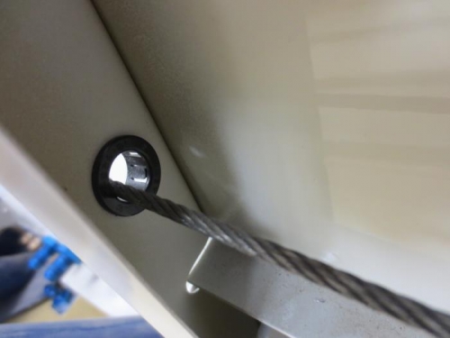

Then I chamfered down the left rudder cable that was catching as full left rudder deflection is applied. I also turned around the black hole insert so that the larger end was toward the firewall. I did this to the right one several months ago with good success and the left went on to the punch list. Now I can give full rudder deflection without it catching and knocking out the hole insert.

Chamfered rudder cable
Put the large end of the insert forward
Rudder cable does not catch
