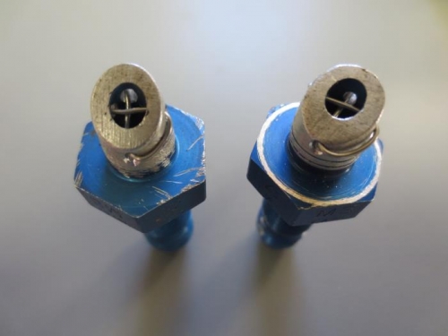

Fabricated fuel vent inlets
I took some spare bulkhead fittings from Carl and fabricated the fuel vent screens. Drilled two holes 90 degrees apart and ran safety wire through them. I will put these away and install them when the time is right.
Fuel vent inlet screens
