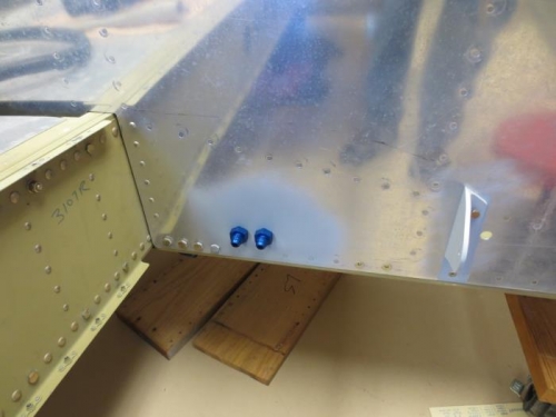

Brief Description:  Installed fuel supply and return fuselage fittings
Spent some time reviewing drawings and installing the fuel supply and return fittings through the fuselage. I needed to install bulkhead fitting because my wings are going to be off for awhile while I am working on the avionics, interior, canopy, etc. If I did not install the bulkhead fittings I would have had a section of tubing extending from the fuselage about 4-5 inches. I would have enevitably knocked and bent the tubing. This will allow me to install the tubing from he edge of the fuselage to the duplex valve while the wings are off.
Left fuel supply and return
