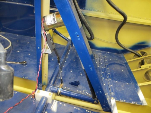

Brief Description:  Installed flap position sensor
I installed a Ray Allen POS 12 sensor for the flap positioner. I am going to incorporate this signal into the Dynon Skyview and buttons on the Tosten grips. I duplicated the design that I have seen several people have used. I installed a WDG-16 clamp on the flap control arm and connected it to the Ray Allen sensor with a 4-40 aircraft radio contol pushrod. I fabricated a bracket and riveted it to EF-602.
The sensor repeatedly reads from 1.1 ohms to 5.1 kohms. I have updated my wiring diagrams and installed a Molex connector on the sensor leads. I still have to install a connector on the flap motor leads.
Flap position sensor installed
