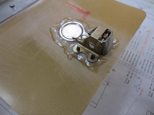

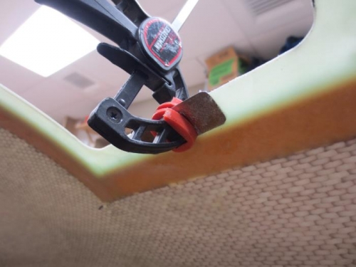

I applied epoxy and cotton flox to bed in the oil door latch and SS backing plate. After this I will apply two reinforcement strips on the backside of the oil door so that air pressures will not distort the door and make it pop open in flight.
Bedding in latch
Beddinng SS back plate
