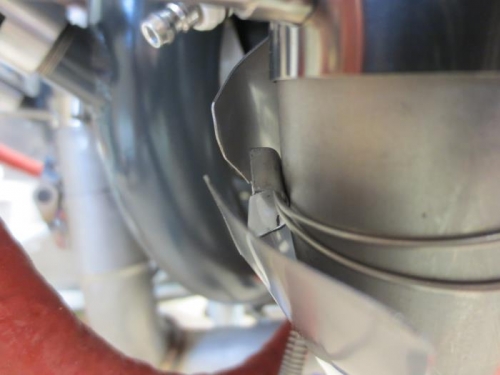

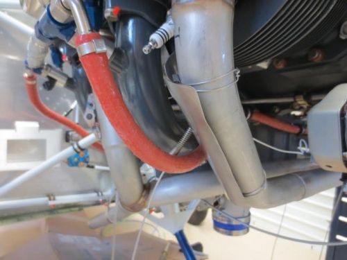

The EFII crossover fuel line was too close to the #1 exhaust header. Fabricated from a piece of SS sheet and fastened with safety wire.
Heat shield on #1 exhaust
Fabbed SS clips
Safety wired heat shield
