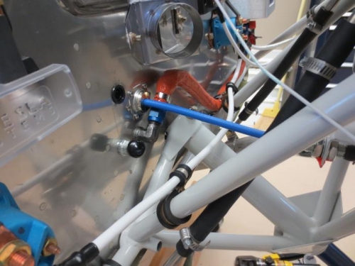

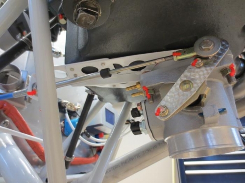

Brief Description:  Installed throttle cable
I installed a throttle cable by McFarlane. It has a vernier capability without the push button. This took many iterations and I had to drill an additional hole in my custom link on the EFII throttle body. I needed to have a little less cable travel. Moving the hole about 1/4" down the link allowed the cable to operate properly.

Throttle cable at firewall
Throttle cable at throttle body
