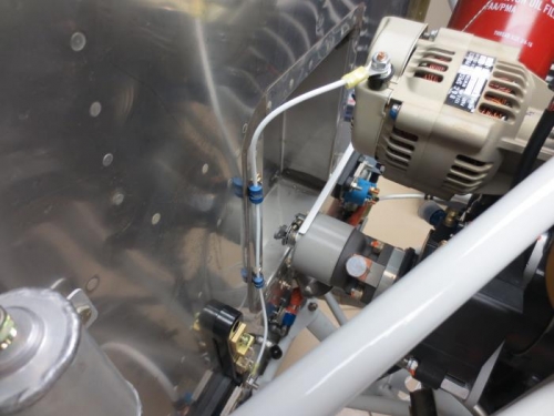

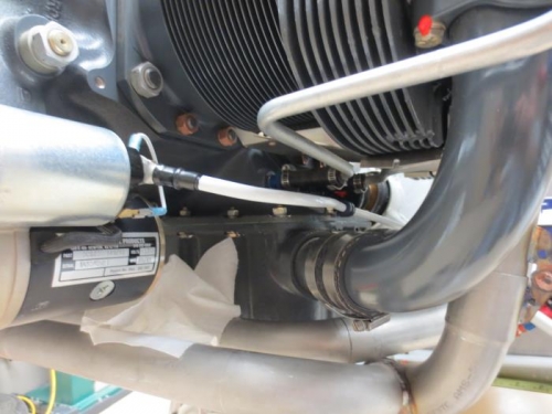

Brief Description:  Installed BU alternator and starter wire
Installed a #10 backup alternator wire. This alternator puts out 30 amps. That will give a 10C rise in the wire but the load on this buss is 10 amps. This will be less than 5C rise in wire temp. The starter wire is a #4 AWG.
Installed backup alternator wire
Installed starter wire
