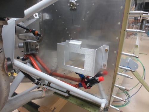

Brief Description:  Installed two battery boxes
Installed the battery boxes today. I am planning for the EarthX batteries. My system has a main battery bus and an essential battery bus. Each has its own battery. One is mounted on each side of the firewall. There is room to remove each battery without removing any hardware. I am going to leave the real estate above each battery box clear for the removal.
Left side battery box installed
