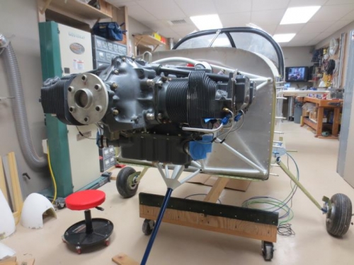

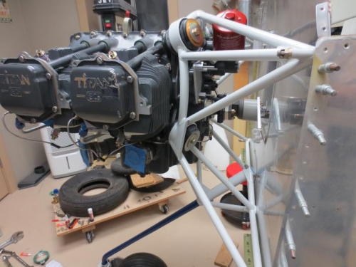

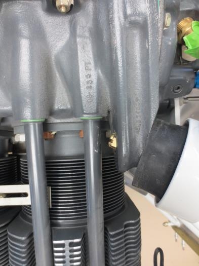

Today I got the engine mounted. First I mounted the governor then I realized that I needed to get the engine on the mount so that I could see how the other components were going to interfere with each other.
After the nose gear was installed I hoisted the engine and installed the Lord mounts. That sounds easy if you say it real fast. It did go pretty well. I was able to position the engine, compress the mounts and install all of the bolts. The bolts are snug but not torqued at this time. I am going to install metal lock nuts instead of the castle nuts. This is common with certified aircraft and acceptable to Vans. Easier on me as well.
Front quartering engine
Side view engine
Side view engine
Top view
Top view
