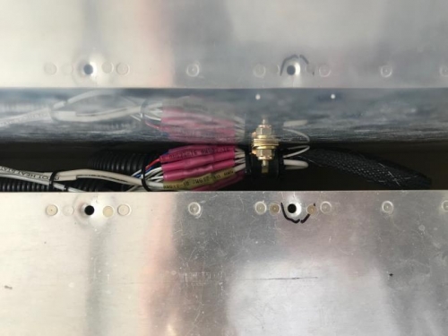

Date:  7-21-2019
Number of Hours:  8.00
Brief Description:  Wired wings to fuselage
I wired the wings to the fuselage with butt splices. These have shrink tubing built in. The shrink tubing has glue on the inside so that when heated in shrinks and makes a water proof joint. They were grouped together and fastened to the fuselage using an Adel clamp.
Wing wiring
Wing wiring
