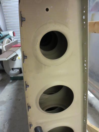

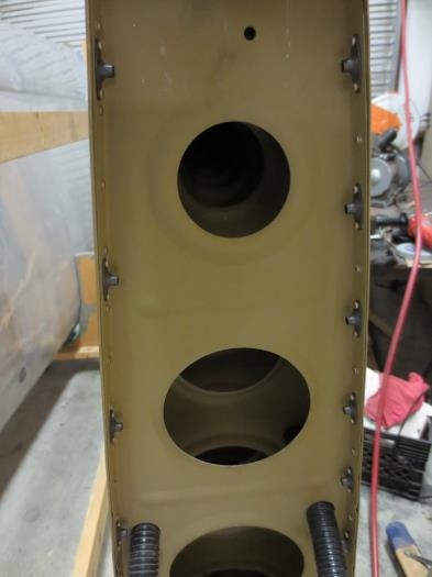

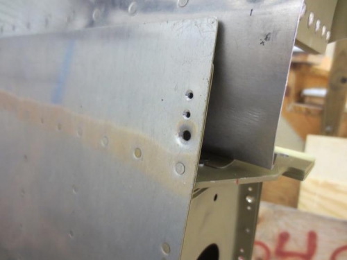

Spent the day drilling, countersinking, dimpling and pulling rivets to install the plate nuts on the wing for the wing root fairing. I got 3/4 of them done. I have to order two offset #8 dimpled plate nuts, MS21053-L08. Installing a regular plate would have interfered with adjacent metal.
Right wing done
Right wing done
Half of left wing done

Need offset MS21053-L08
