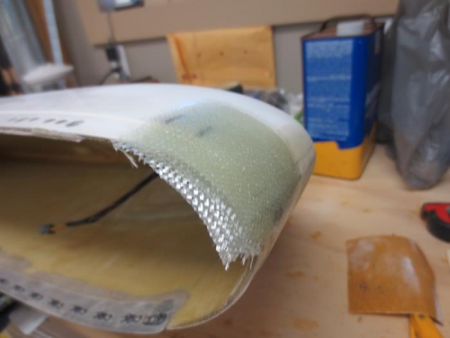

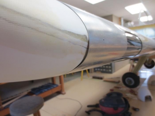

I have had several people come by the shop over the past few months to look at my build. Every single person that does not have any experience with aircraft construction always points out a 3/32" gap between the wing tip and the front edge of the right wing. So now I notice it every time I walk by. So I am going to fix it.
Marked the area on the wing tip, removed it and laid up several layers of fiberglass. I added more than necessary. Easier to remove than having to add more back later. I used West 205 fast hardener. Maybe I can sand it down this evening.
