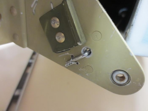

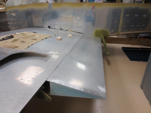

Spent the day working on the remaining wing control surfaces. I installed the left flap control rods and adjusted the linkages so that they are extended to 44 degrees. I installed the safety wire on hinge pin. I fastened the hinge pin to the aileron bracket.

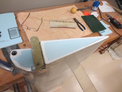

I then installed foam inserts into the ends of the aileron control surfaces. Once this cures I will sand them down and put a layer of fiberglass.
Left flap installed with no interference
Left flap hinge safetied
Still working on sealing ends of control surfaces
