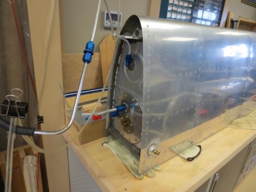

Brief Description:  Pressure testing left wing tank

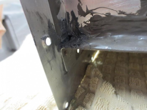

Today I pressure tested the left tank. Had to fabricate tubing connections to manometer and to pressure tank. I found a leak on the outboard rib bottom at the back. There was a 1/8" hole in the ProSeal that I had to seal. I hope that I got all of the soapy water cleaned properly from the area. We will see tommorrow when I retest.
Pressure testing left tank
Leak in ProSeal on bottom of outboard rib on left tank

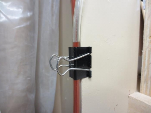

Marking manometer
Marking manometer
