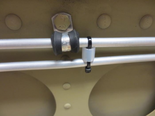

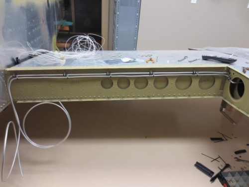

Brief Description:  Installed AOA tubing standoffs
I needed to run the additional AOA pitot tubing from the mast down the wing. The original pitot tube was bolted to the spar and those nuts are not accessible at this time. I fabricated standoffs with tie wraps and a piece of nylon tubing. Next I will run the tubing through the side of the fuselage.
Standoffs for the AOA tubing
Pitot tube running down the wing root
