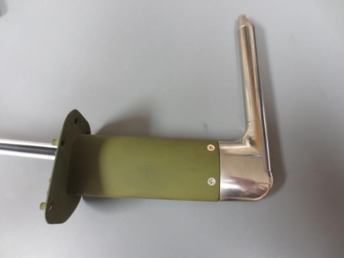

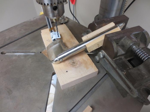

I drilled the pilot holes in the pitot tube in the drill press. I then tapped them for 6-32 screws. In stalled the pitot tube in the mast and countersunk the mast with a hand held chamfer tool. Installed the screws for a nice flush mount. Tomorrow I will work on running the tubing for the AOA port.
Drilling the holes in pitot tube
Countersunk screws installed
