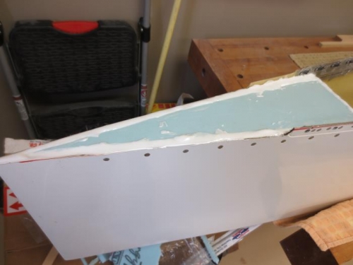

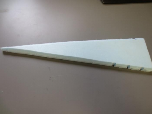

Brief Description:  Sealed right wing tip trailing edge
I continued with my plan to seal all of the control surface edges. This is the right wing tip inside trailing edge. I cut the foam to size, chamfered the edges and expoxied it in place. Tomorrow I will sand flush and lay a layer of fiberglass to seal.
