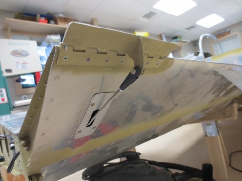

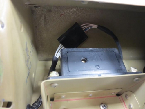

Installing the aileron trim servo today. I forgot to do this before I closed up the left wingtip. Best laid plans... I installed the servo and ran the wiring down the wing. I installed a Molex connector at the MAC servo so that the servo an be removed. I also installed a Molex connector on the wing rib so that the aileron could be removed. The wire is positioned securely so the aileron deflection from full up to down without the wire chaffing. I installed antichaff sleeving on all exposed wire.
Aileron trim mounting side view
Aileron trim with connector
