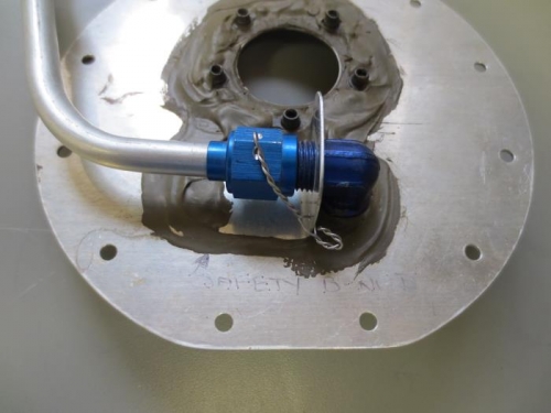

Brief Description:  Safetied the fuel pickups
Today I safetied the tubing nuts to the fuel pickups. I marked the top position of the nut as installed, removed the nut, drilled the hole in the nut and drilled a hole in the bracket on the elbow. I then reinstalled the fuel pickup and safetied it to the bracket.
Left wing fuel pickup safetied
