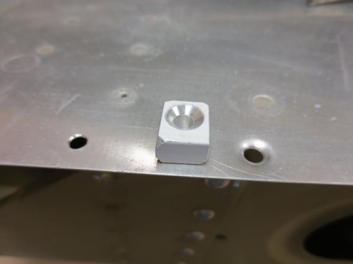

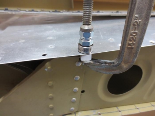

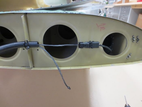

Brief Description:  Finished right wing tip
I finished the installation of the right wing tip to the wing. I ran the wiring through the conduit for the nav lights and landing lights. I then drilled the holes larger in the wings, deburred and dimpled. I installed all of the 6-32 x 3/8" screws. I had two of them give me problems and I had to replace the nutplates. A few of the holes were too close to allow the use of my traditional dimple dies and I had to fabricate a custom die.
In the end the wing tip is one and hopefully I will not have to remove them for any reason.
Right wingtip wiring
Tool for dimple
Tool for dimple
Dimple in tight space
