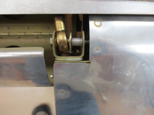

Brief Description:  Set the ailerons
Spent the day setting the aileron linkages. Everything went pretty smoothly. Vans told me not to do any additional balancing to the ailerons other than installing the galvanized pipe. Getting all of the shims and spacers inplace took some dexterity. I have one rub on an aileron push/pull tube on the left wing in the cockpit as it passed through one of the floor ribs. Will need some slight work with a dremel tool. About a 1/32" interference.
Matching aileron to wing tip
Matching left wing tip
Aileron linkage connection
