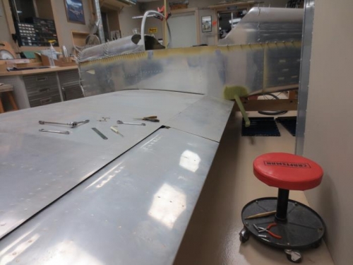

Brief Description:  Installed ailerons

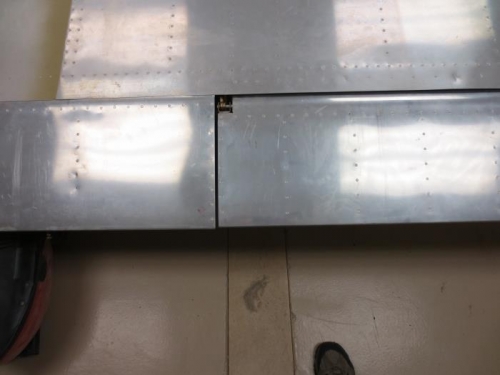

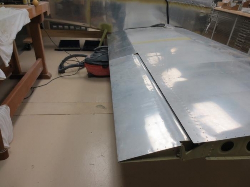

Installed the ailerons today. The rights side is connected but I still have to connect the linkage on the left. I have a 1/4" gap between the aileron and the flap on the left and a 5/16" on the right. Tommorow I will look to see which I am going to adjust to make equal. I will also connect the linkage on the left. I currently have the control sticks in the cabin secured in the neutral postion. I have sent an email to Van's today because my ailerons are trailing edge heavy. Someone had told me that these need to be balanced but I do not find any working in the manual or the drawings.
Left flap and aileron
Right flap and aileron
Right flap and aileron gap
