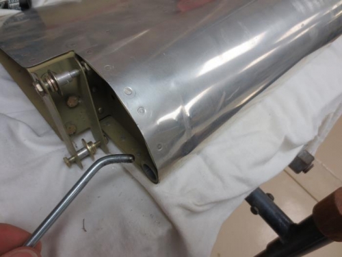

The aileron has a dent in it that I noticed during my purchase. I was able to fabricate a rod and insert into the end of the aileron and push out the dent. When I remove the aileron to seal the ends I will smooth out with epoxy and microballons.
Dent in aileron
Dent pushed out in aileron
