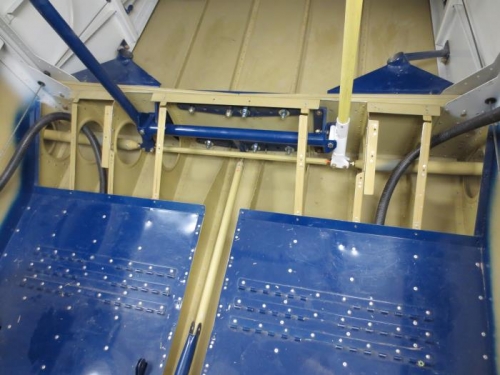

Spent the day fabricating the aileron push tubes. Installed the tubes then I thought that it would be easier to install the flaps first. The flap hinge rod goes through the aileron bearing bracket and it is easier to install with the aileron out of the way.

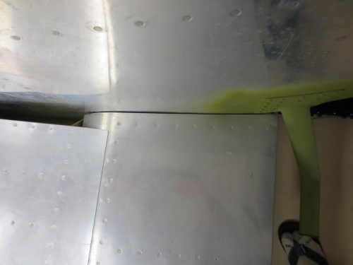

Spent some time fitting the flap to the fuselage. Got a nice 1/16" - 3/32" gap down each side.

Aileron Linkage installed

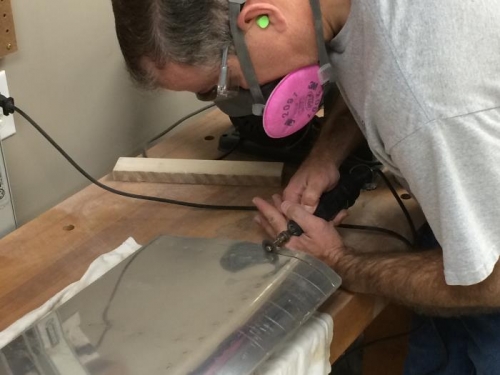

Trimming right flap
Trimming right flap
Flap gap
Flap gap
