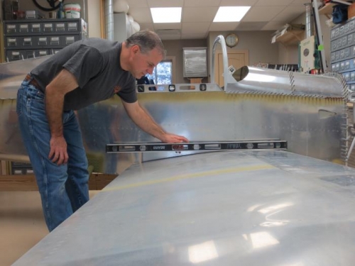

Brief Description:  Drilled rear wing spar bolts
Measured, leveled, repeat, repeat, repeat. The wings measured on the triangulation within 1/16", perfectly straight across the front and the incidence with the 3 1/32" block was right on. I measured the incidence at the root middle and tip. Drilled the holes progressively to 5/16" and bolted them down. This is a major milestone for me. Been dreading it. It was painless.
Setting wing incidence
