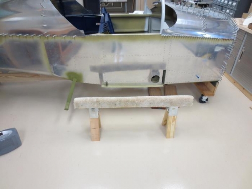

Brief Description:  Temporary wing supports
In anticipation of installing the wings I fabricated these special short carpet covered sawhorses. I will need these until the aircraft is on its own gear. The fuselage cart will tip once the wings are installed and stood on to enter cockpit. I calculated the height of the sawhorse to be at midspan taking into account for the dihedral in the wings.
Carpet covered sawhorses
