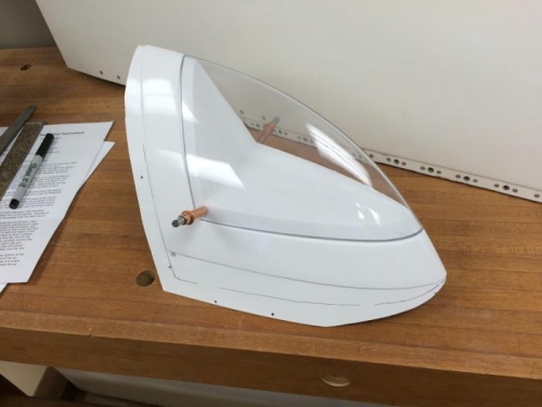

Brief Description:  Fitting lens to wing tip kit

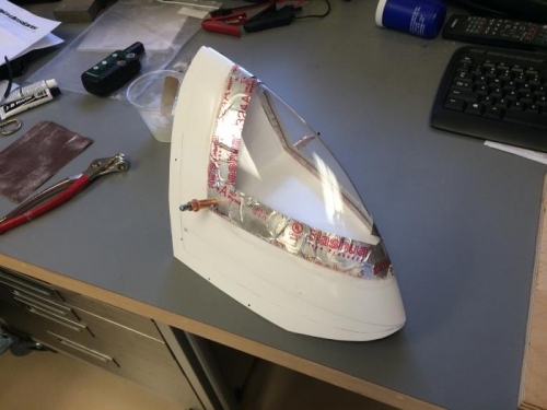

I trimmed the lens cover to the wing tip fiberglass part. The instructions then call to bed the lens cover to the wing tip part. I covered the lens with aluminum tape and waxed. Mixed a batch of epoxy with lots of microballons to make a paste. Let cure.
Lens fitted

Lens bedded
Lens bedded
