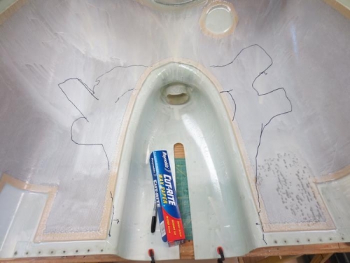

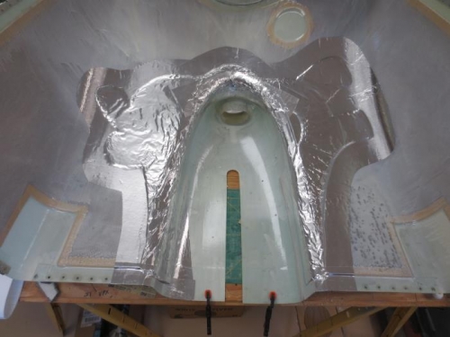

Brief Description:  Applied cowling heat reflecting material
Put the cowling back on and marked the areas that the exhaust stacks come close to the lower cowling. Applied 1/8" Fiberfrax material and covered with SS adhesive backed foil. Most likely I will have to add a little more down in the bottom but I am waiting on a couple of parts from Vans. Once I install them I will be able to complete this job.
Layout
Layout
Pattern
Pattern
Fiberfrax under SS foil
