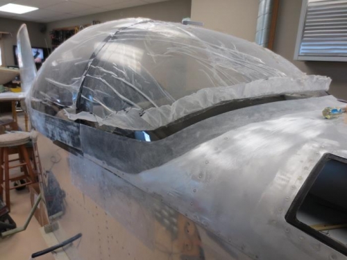

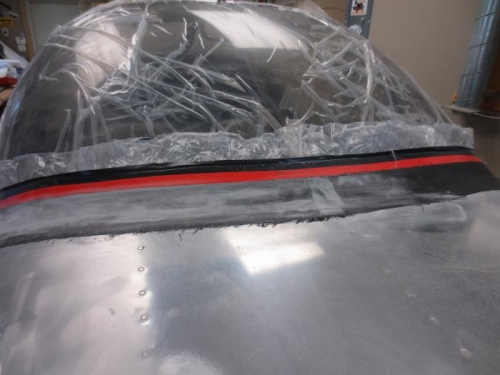

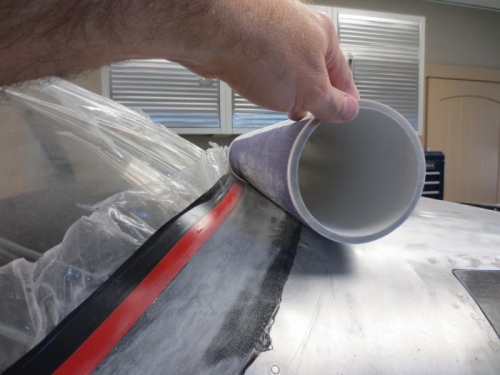

Completed the windscreen fairing. Used a 4" piece of PVC pipe as described in the manual. Just took a LOT of time. Sand it off, fiberglass more on, sand it off, etc. This is a condensed version of many hours of work.
Radius the fairing
Started sanding
Sanding going well
