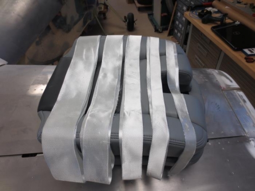

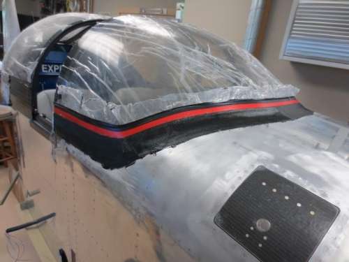

Brief Description:  Applied fiberglass to windscreen fairing
I precut several lengths of fiberglass in preparation for the windscreen fairing. Black pigment was mixed in with the epoxy so that the view from the inside of the cockpit would look finished. The layups went well and I just need to add some more fiberglass to the back bottom edge of the fairing where it meets the canopy.
Fiberglass for windscreen fairing
Fiberglass applied with black pigment
