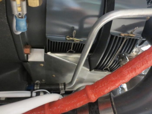

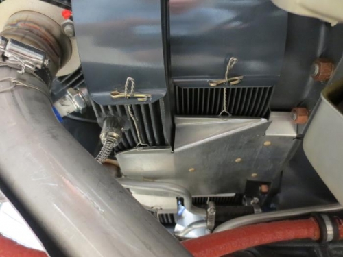

Brief Description:  Bottom cylinder engine baffle
This was over a course of two days. An IA friend of mine came over and gave the plane a once over. He found that I forgot to tie the bottom cylinder baffles together. It pays to have an extra set of eyes looking things over. Next I am going to apply a little bit of caulking on each end to keep the ends from fretting.
