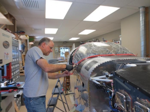

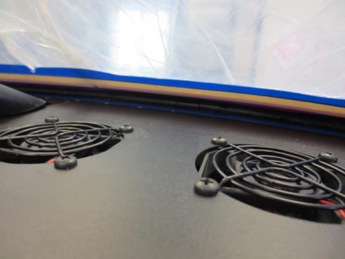

Brief Description:  Continue installation of windscreen
I laid a healthy bead of Sika 295 D under the front edge of windscreen on the fuselage and set the windscreen into it. This is the way to go. It oozed out on the front and back side and made it easy to smooth it out. Around the roll bar I installed Sika between the spacers. Once the Sika sets in a couple of days I will pull the spacers and apply a finish coat to fill in the gaps.
Applying Sika
Applying Sika
Pulling tape
Pulling tape
Inside seam smoothed out
