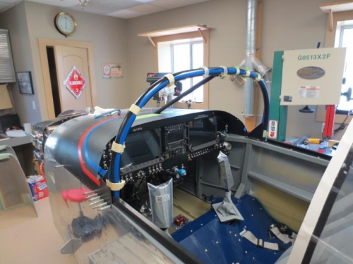

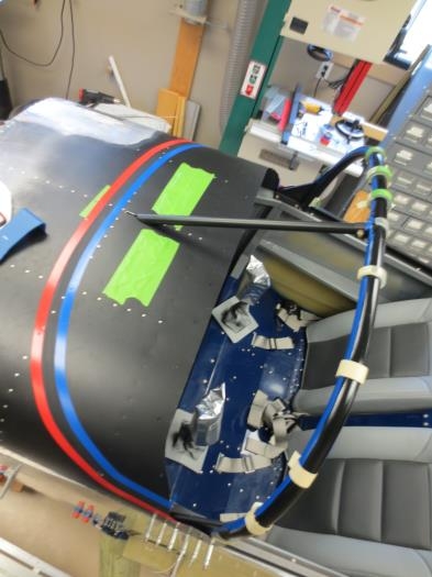

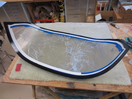

Brief Description:  Installed windscreen
I installed the windscreen today. I prepared all of the areas that were going to take the Sika adhesive by sanding with 150 grit, then applying 205 activator, waited 5 minutes, then applied 209 D primer with a foam brush. After 30 minutes, I installed the windscreen.
Windscreen taped and primed
All taped off
All taped off
Canopy bow spacers installed
