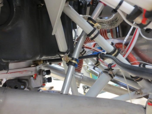

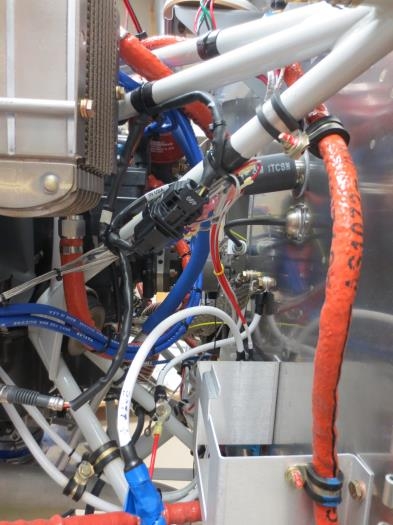

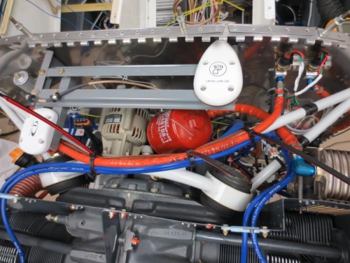

Brief Description:  Installed crankcase breather
My crankcase breather hose is made from 1/2" blue reinforced silicon for longevity. Replaced stock fitting with 1/2" Parker push-on fitting, I used a piece of Van's crankcase tubing for the last few inches so I could be positioned to burn it off on the exhaust pipe.
Crankcase breather on exhaust
Left side firewall
Left side firewall
Top of firewall
Top of firewall
