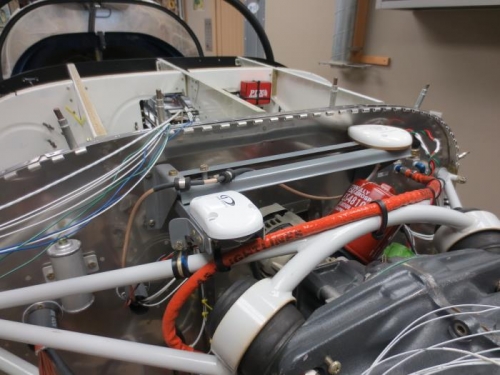

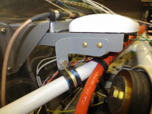

The right side Dynon GPS puck extend from the firewall and was not well supported from the thin SS firewall. The added support makes the mount rock solid. These hours were from two days of work. Had to wait for the paint to dry.
