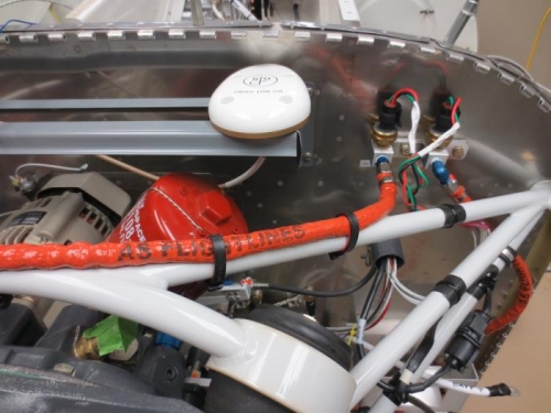

Brief Description:  Installed oil pressure sensor line
Installed the oil pressure sensor line. Teflon lined, stainless steel, and firesleeved lines from TS Flightlines. Used these new zip ties I picked up at Oshkosh. They have silicone ridges on the underside of the zip ties. They protect the paint and keep the ties from moving.
Oil line connected to sensor
Oil line crossing over
Oil line connected to engine
