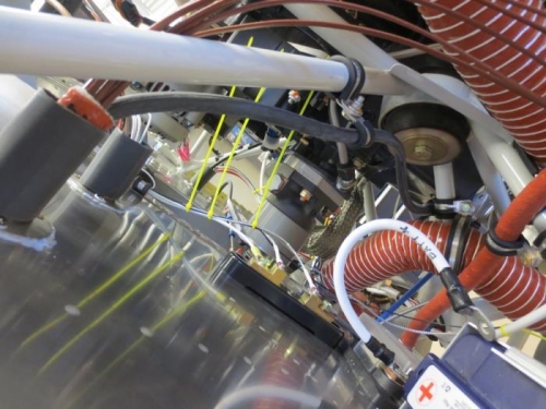

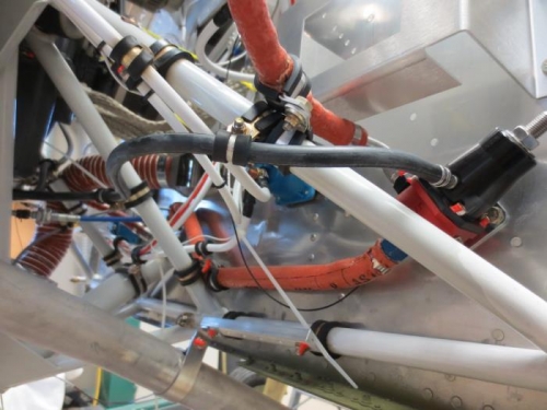

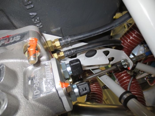

Brief Description:  Installed manifold pressure lines
The EFII system has two manifold pressure sensor taps between the throttle body and the oil sump. One of the lines will go to the fuel pressure regulator on the lower pilot's side of the firewall. The other will go through the firewall and be split between the two EFII manifold pressure sensors and the one for the Dynon system.
Manifold pressure lines
Pressure line to fuel regulator
Pressure line to manifold pressure sensor
