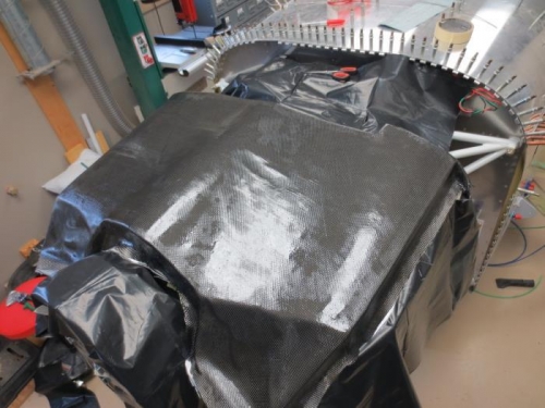

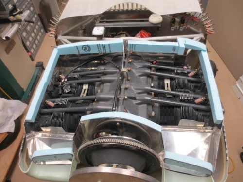

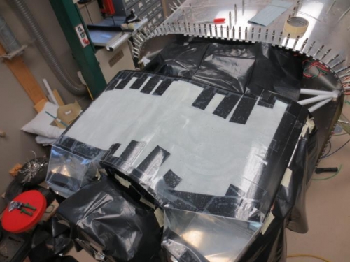

Worked on the top plenum. Some of this time was spent last night. Just rolled it up into one construction log. The first layer was a fine weave fiberglass. This was to give a nice smooth aerodynamic surface for the air as well as an insulating media between the carbon fiber and the aluminum. Then I added two layers of carbon fiber. Tomorrow I will pop it off and trim it up.
Forming up the top plenum
Ready to glass the top plenum
Three layers applied
