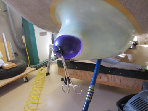

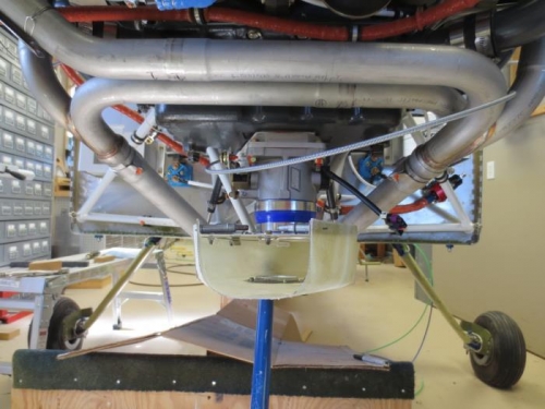

Brief Description:  Laid fiberglass on FAB
I have the FAB mounted and filled the void with spray foam, let it cure, and then used lightweight spackling to smooth the transition. The first layer of fiberglass used was a 9 oz fabric 5" x 12". Used a 9" ballon to form the fiberglass to the FAB transition.
Fitting filtered air box
First layer of fiberglass installed
