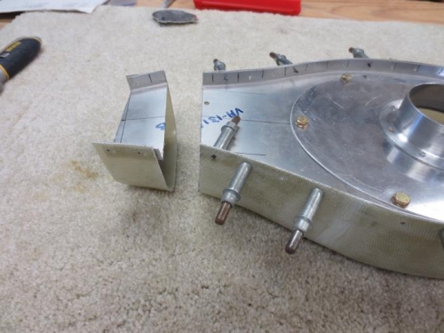

I deviated from plans a litte. I cut the FAB back a little further. I saw this done by other and it makes for a cleaner transition to the cowling.

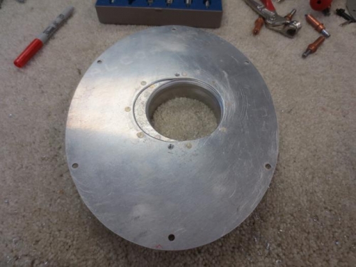

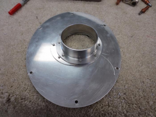

After that I installed the FAB and found that it was about 3/8" from the left side of the cowling. I took apart the inlet and fabricated an offset.
Cut front end off of airbox
Air filter offset bottom view
Air filter offset top view
