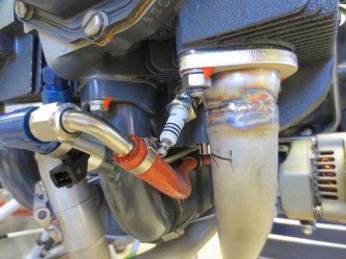

Brief Description:  Resolving fuel line clearance
I looked at the fuel line that crosses over between cylinders 1 and 2. Installed the spark plug and the fuel line is too close to it. Removed the fuel line. I am going to replace it with one that is 2" longer. This will allow the 90 degree fitting to go straight down before crossing over. The spark plug connector will clear the fuel line after the replacement.
Fuel line too close to spark plug
