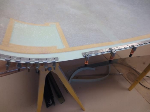

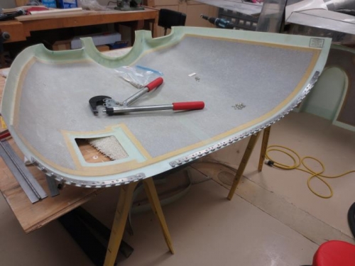

Installing hinges on upper cowl
Laid out the hinges, clamped to the fiberglass, drilled, countersunk, applied fiberglass and flox, and riveted in place. It goes real fast when you say it that way.
Drilling holes in hinges

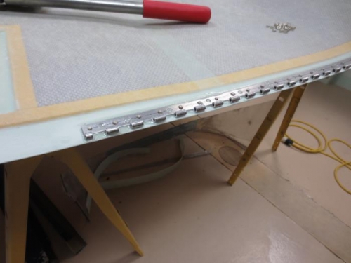

Hinge installed
Hinges glassed and riveted
